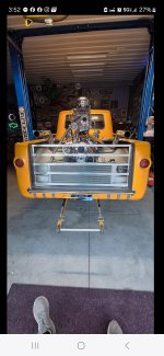

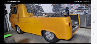

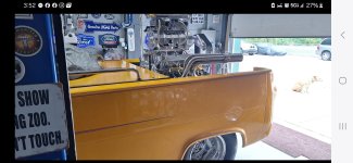

1967 Dodge A-100 Hot rod sort of rat rod build thread.
Casale V drive.

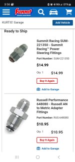

Well looks like crisis averted and easier than I thought. Although that bulkhead fitting is in there backwards so the 45 directs the oil down away from the top of the resi. Meaning I have nothing to grab onto and might have to put a pair of needle nose on it to hold it to tighten the fitting. Had to order those weird fittings that are metric on one side and -6 a.m. on the other. (Going into the Hydroboost.)

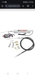

So with two hydraulic systems for the brakes there is a Wilwood master in the cab which is part of the first system. Which engages a Jeep clutch slave cylinder which is part of the second system. If anything ever fails in the first system I will lose brakes. So important that I put a real good emergency brake setup in this truck. Really don't have space for a manual lever so I'm considering the electronic e-stop kit. It is a simple push button design and the actuator creates 600 lb of pull to engage the rear emergency brakes. Not only an emergency brake but a safety as well. Thinking this will be the hot ticket. Other thing that is cool is a theft deterrent. You can only engage and disengage when the key is turned on. So once it is locked and you remove the key the rear brakes stay locked.
