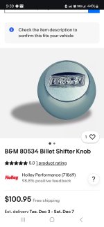

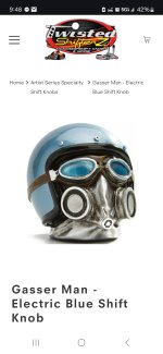

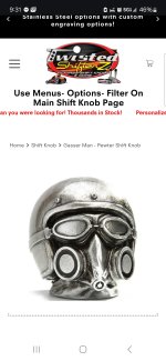

Well I'm down to either one of these shifter knobs. Really like them both and can't decide which one I want. Also finally figured out how I'm going to build my center console at least in my head right now. Going to buy a couple new smaller hydro flasks and then use the slip roll and make tubes for them to sit down in the console. Then wrap and weld some chain around the top of each one.

Order them both in Laguna which I think fits the color palette of the truck well.

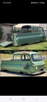

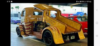

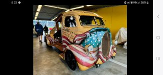

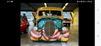

Would love to get more info and photos on this truck. Super cool.
