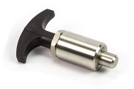

How tight is your cable, it might not be allowing the pin to extend far enough
The cable sits loose, and yes the pin is bottomed out in the assembly.  I agree the window frame assembly isn't twisting up enough to let the pin out... but I'm wondering if the actual impacts of tumbling allow the pin to cycle?  A stiffer return spring would solve that, I suppose... and/or a slightly longer pin.
I hadn't though of flopping appendages being the culprit, but it does sound plausible.  Wouldn't be hard at all to just remove that wire and honestly, operation isn't that much tougher without it.

Trying to see how that latch works. Is that like some sort of catch on the door frame pillar? Do you think if you cut the welds and moved the “T” pin assembly out and reweld it would work? What are your thoughts?
I'm not sure I follow.  It's a super-simple assembly.  It's basically just a spring-loaded pin with a "t handle."  This isn't the exact item, but basically this:

The pin goes into a hole in a block that's just clamped around the cage:
Now that I mention it, I'm wondering if that clamp is rotating allowing the pin to release?  If so, I'm sure it'd be pretty easy to just put some rubber under the clamp and keep it good 'n tight to avoid that issue.

Yes the clamp is what I was asking about. I was wondering if that was moving or something?
Very possible... I was thinking in a bad wreck (like Max had) either flex in everything or the force or an arm hitting the window net hard could rotate it.  Either tacking it in place, or putting rubber under the clamped-in block and making sure it's super tight might be a simple fix.

I'm catching up on the window net posts. It looks like that mechanism is fairly robust.  I figured it was something a little more lightweight.  The gap between the window net frame and the block on the cage looks fairly tight too. I guess a hard front impact could maybe cause the weight of the pin to open itself? Does the gas strut put a lot of outward pressure on the net (trying to open it) while it's latched? Seems like everything would have to happen just right (or wrong) for that to open, assuming that's the cause.

A 1/2" stroke on the pin imo isn't enough when taking into consideration frame flex and other factors. Maybe a 1" stroke ? Or more.
To be fair I didn't actually measure stroke.  Like I said, that is not the exact part, just a representative *similar* part.
