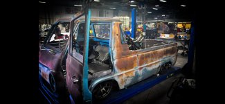

Got the headlights all wired in today. Shiny back LEDs are much better. The little plastic plugs were old and brittle so I just cut some circles out of quarter inch thick rubber and then used the cut off wheel in the grinder to put a little notch in it.
