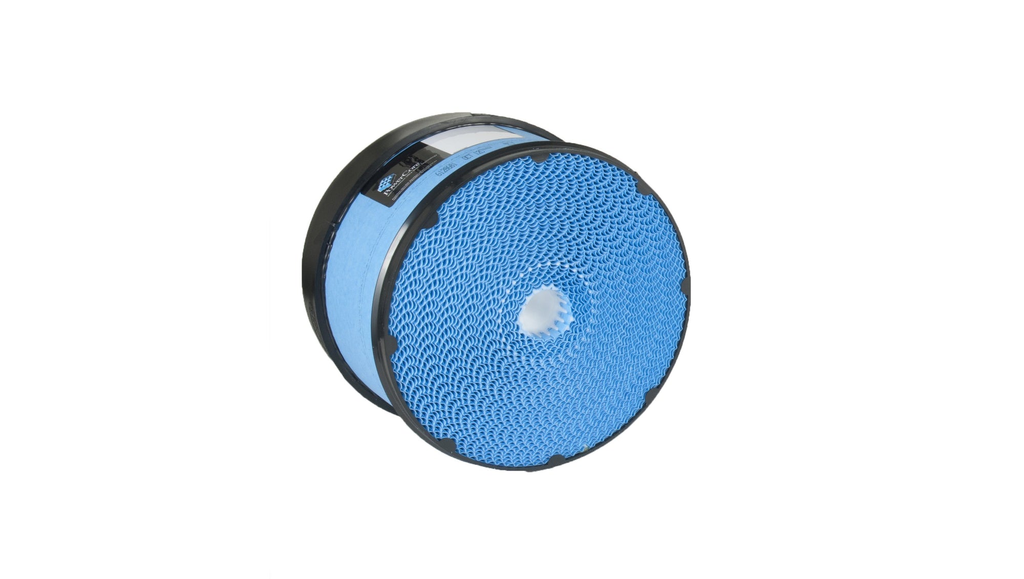

Couple of air filter options / styles
https://volant.com/collections/powercore-filter/products/powercore-air-filter-61504
https://www.knfilters.com/rx-4130-1-universal-x-stream-clamp-on-air-filter?gad_source=1&gclid=CjwKCAiA1MCrBhAoEiwAC2d64f79EqMfXPcf_yQASbFHfXq6Y7FO4vGk3GQcqV7Io9tAzOrpaCyg4hoCzSUQAvD_BwE
otherwise some kinda fabricated air box and filter inside
I did try calling volant today and they said I need to call Donaldson because that is one of their filters. Sat on hold for a while and gave up. I wanted my cold side turbo tubes up in the air so I built the airbox up 7 in. Also factoring in was this gets it high enough to keep the plastic fans away from the header. At least I think that will be okay. One panel down and three more to weld in. Then it will get some body filler at all the joints and smoothed out. Still need to cut the hole out in the wood as well. First panels I have bead rolled that you can see. Bead rolling is definitely not as easy as it looks.

So the air inlet to this turbo is 4" Will a small k&n filter flow enough air? Something only 6 in tall would be nice. Meaning the element itself would only be 5 in tall. I assume five or six inches diameter. I think I've seen the tapered ones as well. I think it would look better with a black outerwear on it as well.
I know it's a way bigger filter than you want but the napa 6637 is available everywhere, flows a ton of air and filterwears makes this outerwear for it in a few different colors IMG_20231208_220700.jpg
