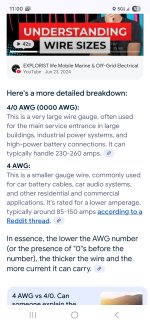

This is the two gauge we have on the cart. Certainly not as fine as welding wire would be.
