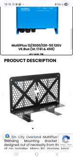

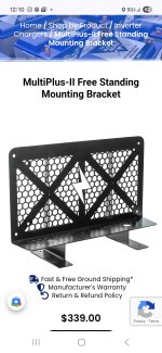

Both of my forklifts were down so today I had to do repairs. New tube on one front tire of one and hydraulic hose on the other. I had some heavy duty strut channel laying around so I just cut that and used it. Got some white paint on it. Tomorrow ready to start installing the panels on the roof. I'm going to have to mount my inverter sideways. Found a company that sells a cool bracket online but for $340 I will make my own. I'm not sure how all the wiring is going to get hooked up yet. Here is the inverter in the coach now and has 4/0 cables coming out of it. There are two big ground wires coming from it. I need to trace some of those wires down and figure out where they go. It currently has a 300 amp fuse but per my manual I ordered a 400 amp. I bought a 10 cubic foot insignia fridge this week which just fits in the hole. Realized with the swing of the door and the hinge I'm going to have to pull it out and protrude the doors out a couple inches. So I returned it to Best buy and ordered a 11.6 cubic foot GE. Basically a zero tolerance fit so we will see how to get that thing in there. Nowhere to see it in the store so I have to buy one to measure it. Says it is 24 in wide and that is how wide my opening is. I may have to cut or slightly sand the edge of the wood. Have to removing the styrofoam I have another half inch to play with. Washer dryer unit goes and I'm turning that into storage. my buddy owns diamond Auto Glass and he's going to have his guys come out and pull the right front glass.

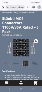

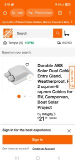

Also reading in several different forums everybody said to run the Staubli mc4 connectors. These are the connectors that attach the wiring to the panels together. A lot of people said do not mix and match connectors even though they will click together. Apparently there have been some issues with wiring burning up. Not sure where my wiring is going to go through the roof but I'm guessing it will be something like this. Roof on the country coaches are 5 in thick.
Staubli connectors are the best and you should not mix brands. Equally important is to use the proper crimping tool. There was/is a video online used to certify installers using Staubli connectors. You can also buy PV cable with connectors already installed. PV cable comes in different strand counts and the fine strand (150) is the way to go IMO.
