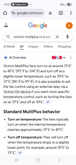

I think I'm finally done. That inverter has a temperature range of -40 up to 150°. Need to figure out at what temperature to turn my fans off and on. Optimum temperature of course is 75 to 77.

Hmmmm.
