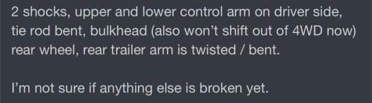

This dude may also suffer from a lack of talent, not just luck.This the same guy a few days later. He is not having good luck with his speed. He is looking at over 12k in parts alone.
Hitting that ledge at speed would break nearly anything not on 40s...This the same guy a few days later. He is not having good luck with his speed. He is looking at over 12k in parts alone.
I am thinking he has some bad luck. The oil cooler line coming off was not his doing. Hitting the ledge was some unfortunate lack of situational awareness which happens sometimes.This dude may also suffer from a lack of talent, not just luck.
