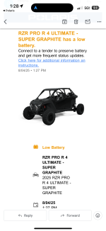

I don't understand how you guys have battery draws all the time. I must be the only person without battery issues in any of my toys. My turn sits in a hot AZ garage and goes months between starting up. currently knocking on wood.Great email to get while the car is an hour away in storage lol. I guess I'll be installing a quick battery disconnect or taking the battery out so I can keep it on a tender at the house. I guess its pretty obvious there's a constant draw since I can connect to it anytime from the Polaris app, didn't think much about it
Pro-r , but my last few i have not had any battery issues, X3, X3 max, RS1, maverick. I guess i just have good luck with batteries. But i hear alot of people with issues. Poor wiring?Which rzr do you have? I can connect to mine anytime from my phone through the app so obviously something's on even when the keys not
This (2023 Pro R) is the first Polaris I’ve had a battery issue with. One stock battery was low, after replacing it the problem was way less of an issue but still there. My buddy’s 2022 has the same problem.I don't understand how you guys have battery draws all the time. I must be the only person without battery issues in any of my toys. My turn sits in a hot AZ garage and goes months between starting up. currently knocking on wood.
Mine does the same thing after sitting for a month in the garage, just got that same message yesterday. 2025 Pro RThis (2023 Pro R) is the first Polaris I’ve had a battery issue with. One stock battery was low, after replacing it the problem was way less of an issue but still there. My buddy’s 2022 has the same problem.
