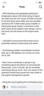

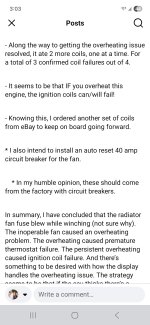

New Kawi 250hp Supercharged SXS

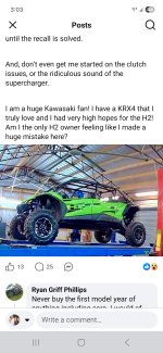

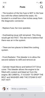

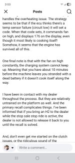

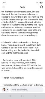

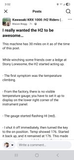

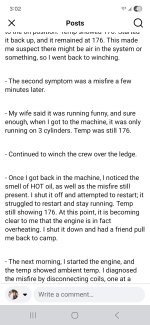

Heavy winching will definitely tax a charging system. If voltage drops enough, fuses will blow.
sounds like the charging system is not robust enough for constant winching in the Florida muck.
