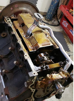

On wet sumps the oil level on a LS is almost to the top of the pan, if the motor is perfectly level with no stroked motor than you have about .500 away from the oil level, In a sand car i can not remember the time the motor was level, pretty much the crank is always in the oil, and adding a 4'' cranks makes it that much worse,What is the results with a dry sump?

If you use a proper windage tray say from Improving oiling and fill properly a 1/2"of clearance to the oil is pretty good - using a crank wiper is even better - these issues are mostly non existent. you have to remember the rods on a stroker often have .060- .080 clearance from the block and the crank is spinning around in the closed skirted block which is the real issue with the LS - the Skirt causes windage - the air compresses and pushes against the rotating mass - the advantage is it actually pushes the oil away from the crank at speed. Its and old Ford design that Chevy adopted to allow the use of a light weight Aluminum block and still have side support for the mains - not a bad overall design the skirts are integral in making the block strong and even the pan is a structural member of the engine ( the reason so many fabricated pan LS engines lose the thrust main...)

Our wet sump with a G8 oil pan kit is about $400, then a windage tray from mast $90, then improved baffle is $200, oil pump with mods $200, oil filter remote block improved racing $170 remote filter block $50-150
