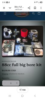

Picked up the big bore 88 kit for wife's 70. Tear down done, starting to put bits together.
Anyone familiar with this kit? Install tips?

This has a beefed up head & cam.

Make sure Yu do high volume oil pump. Those TB kits are Awesome and reliable
With this aftermarket head, you figure drilling won't be needed? Description of the oil pump mentions drilling but assuming that's on the stock head?
