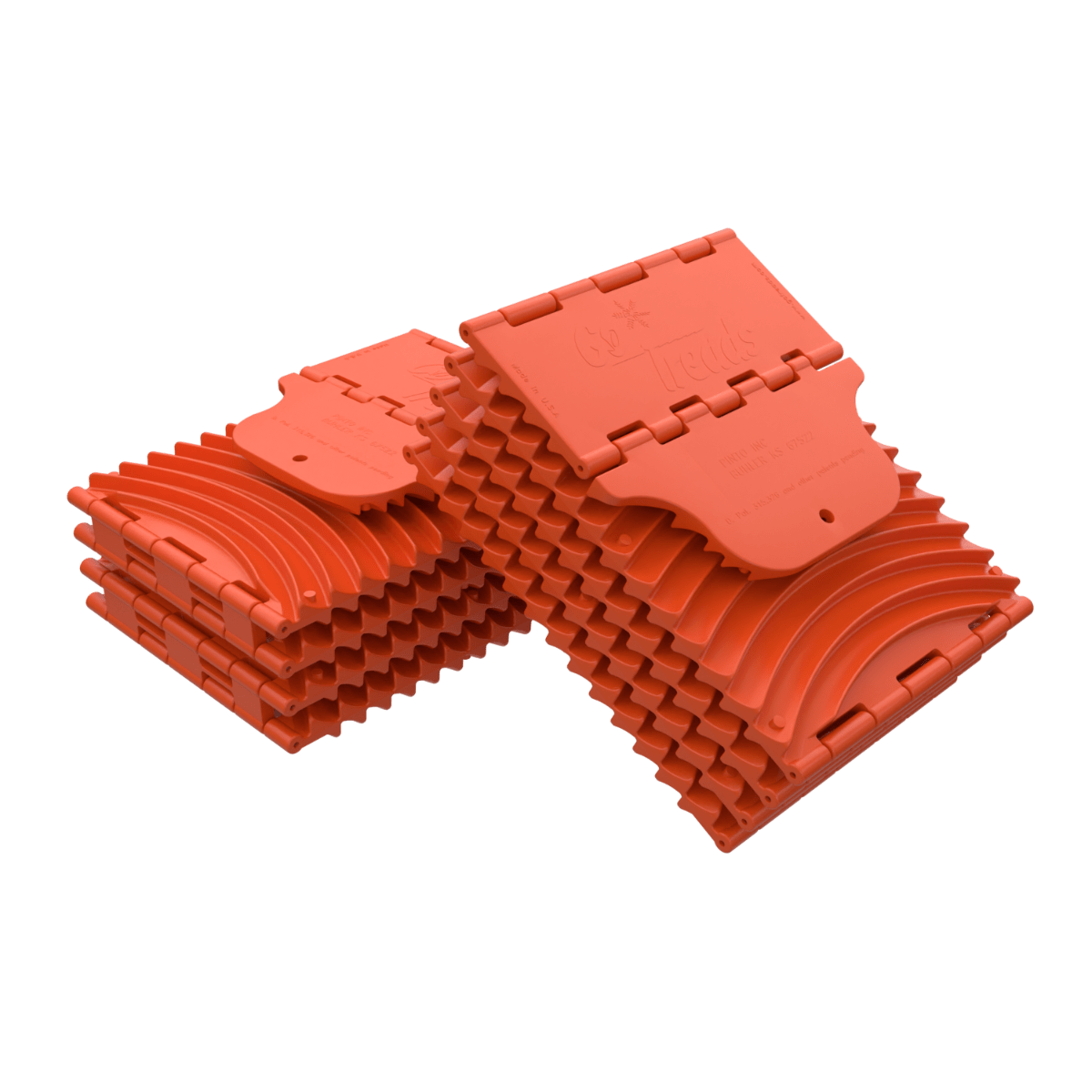

That said I have gotreads in my Moho for this very reason.
I think these are better than traction boards

Traction boards work for the length of the board. I’ve never been stuck in only 4’ of sand.
