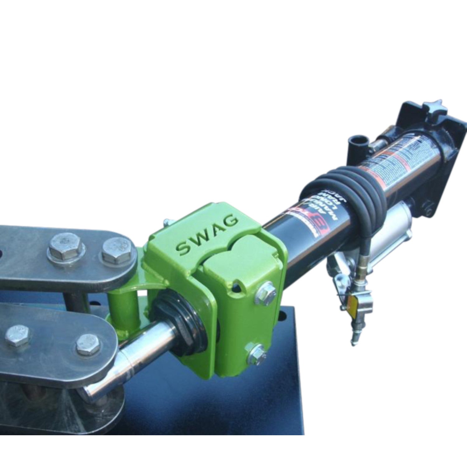

I use to work for Hossfeld and have owned a Protools, rougefab, and now a swag, everthing i get from Eastwood works ok, but never impressed,
I use to bend tubing Horizontal for 20 years, went to a shop where they bent upwards, not that is how i do it, so much more accurate, you can set your tube at zero degrees then bend up, and check with a angle finder, I do not love air over hydraulic, it works ok, but full hydro like LRS is really nice even coverting it to vertical would be really easy,
Due to the bushing in the main pivot is what i was after on my last purchase, the bushing lets you take the die out without the bender coming apart,
Swag for me marked all the boxes,
Then i did the extra long ram from trick tools, and added a full hydraulic to the system, with pedal control,
I have some straight hydraulic conduit benders for work, and they're amazingly fast. Keep hands/fingers away though. Zero fucks given if it's in there. :ROFLMAO:
Electric over hydro is the best setup. Im always super swamped with work and the agony of waiting for air over hydraulic is just unbearable. I will lock in the air and walk away while it bends. I used to run a model 3 with the swag air over. Its hydraulic electric now. Much faster.
Fwiw the model 3 will do 2” .120 4130 air over.
