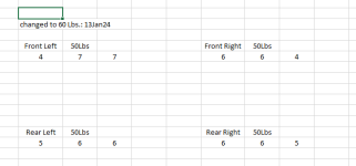

Good morning folks, I have a 99 Dodge Ram 2500, 2x4, Cummins, Auto, Extra Cab.  260,000 miles.
On 15Aug2020, I put some Michelin LTX AT2, 265/75-16, 123R-E1, on it. (Discount Tire).
The tires have 25K miles on them.  this is the first time I've had tires on it that were not AT’s or MT’s.
They seem to be wearing strangely.  The tires are wearing on the outside more than the inside.  See the depths in the chart below.
Any idea what causes something like this?
I normally run 50Lbs in them when Im not towing & 70 in each when towing.  I changed them all to 60 to see if that made any difference, but I cant imagine it will (other than maybe wearing out the middles, which is what it would do to the AT's, which is why I went up & down when towing).
Thanks
Bob

I thought that, but why are the rears doing the same thing?
I did on 4 Dec @250,900 miles.  I have not since.
going to start there.
thanks for the sanity check.

I thought I would try something that was less of a "truck tire" & more of a "car tire" which is why I tried the Micheline.  I have them on all of my cars & have never had an issue.  so far they are OK.  this wear seems odd to me, which is why Im asking.  alignment does make the most sense, but I dismissed it because of the rears, not even thinking I rotated them.  LOL.
It is one of Five things.
1). You are drifting around mountain roads. (this would wear all four)
2). Assuming your front end is tight you need an alignment (this would only wear the fronts)
3). You may have play in the tie rods, ball joints, Idler Arm and/or Pitman Arm - and also need an alignment. (this would only wear the front)
4). You drive mainly on a worn out road where the outside edges of the pavement is crowned downward to the center of the lane. (This would wear all four)
5). The worn ones are under inflated - doesn't sound like that to me though.
Keep us posted.
