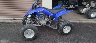

Found a 2011 250r Se for my son.
It's in pretty good shape but it oil smokes  when cold.
I'm a 2 stroke guy but im thinking it's the valve guides. Maybe rings?
Where do I go from here? Compression test? Tear the head off and just do valve seals? Which seals are best? Do I replace the timing chain while it's apart?
Plan to maybe do a big bore ported motor in it after he rides it for a couple seasons so I'd rather not go to crazy replacing parts right out the gate.20211127_165220.jpg
Check the valves as they like to get out of whack on those Raptor 250s.   My kid rode one for several years.   Putting the DASA pipe and a jet kit really helped wake that bike up.
Check the Valve lash?
It's got a little stumble on the top end. The plan was to rebuild the carb and dial in the jetting. Previous owners let it sit for 6 years and didn't know if it had ever been jetted for the pipe and altitude.
I'll look into doing a jet kit.
Getting the jetting right on the 250 helps a lot.   My bet is it was never jetted by the previous owner.
I would check the valve lash and guides.  Poor bike has been sitting a long time.
