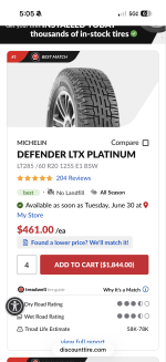

On my 1997 dodge 2500 4x4 diesel I have been running what ever AT BFG was available at the time never a failure don’t know the mileage for all the sets truck currently has 490,000
Just bought another ram 2024 2500 rebel 4x4 diesel got it with 18,000 in January has factory Goodyears 285/60/20 this truck is way faster and better handling than the old one
The factory tires are not up to the on road performance i expect so this will be may next set
They will be fine in. Glamis or any place I will actually drive it IMG_4727.pngIMG_4275.jpeg
