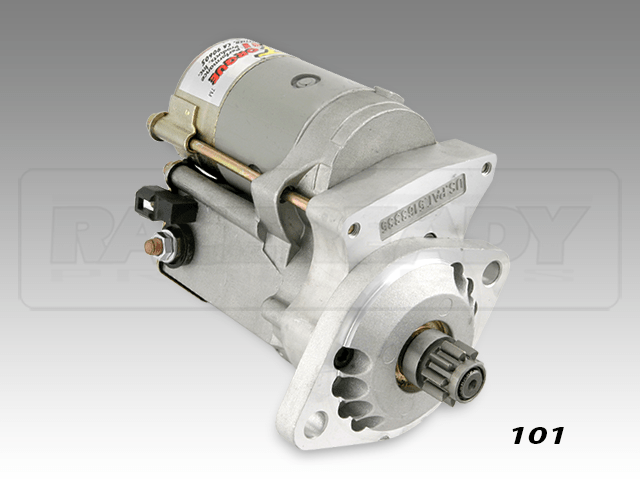

It's a VW bellhousing with a hi-torq starter... not sure I can get any more RPM. Has anyone had this issue before?
Which model? There are a bunch:
Probably need an N model to spin fast enough.

I was going to say get the Tilton Starter. Sounds like a race car turning over so fast.
