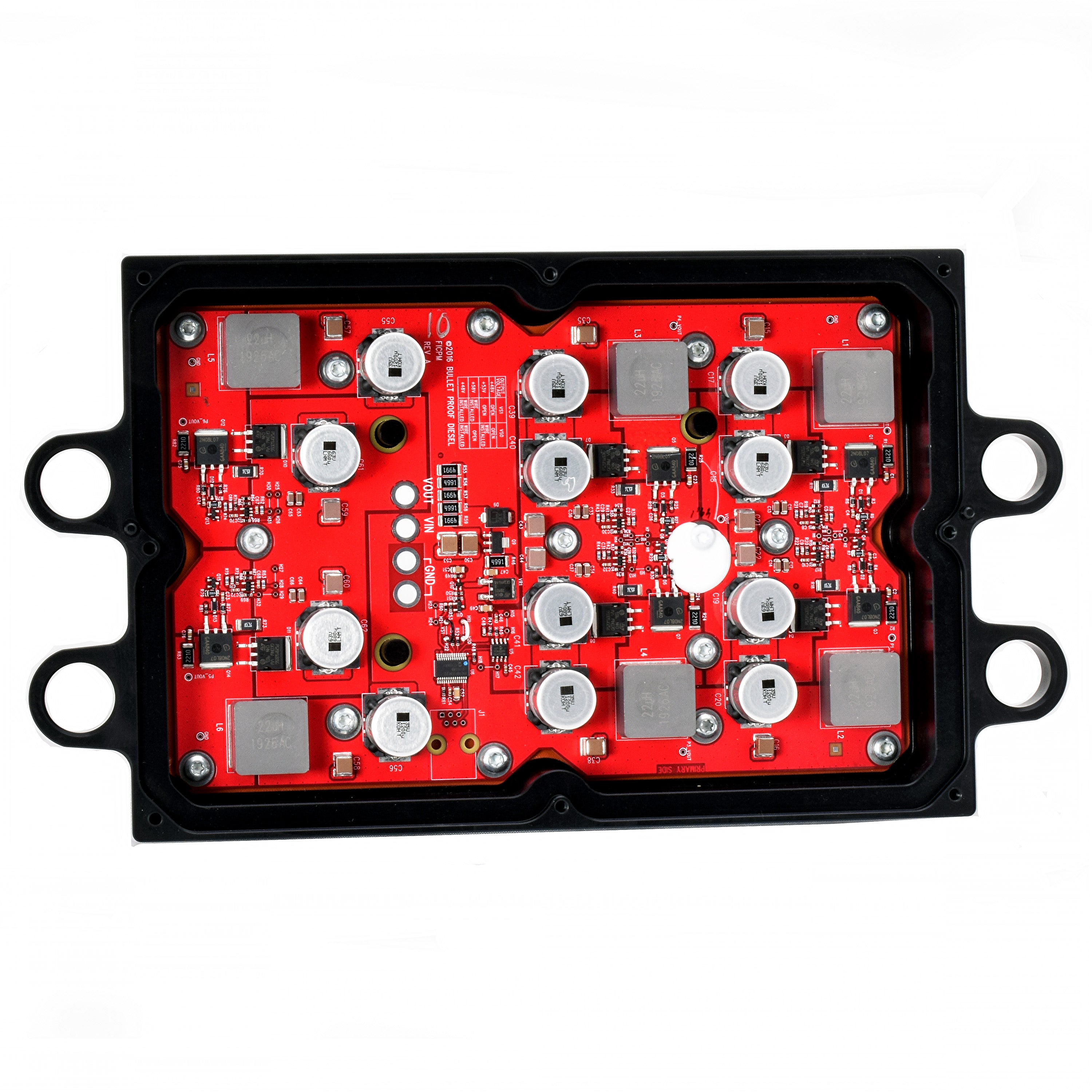

look at ficm upgrades also, someone on here had a 6.0 for a long time, can't remember his name. alot of it depends on the shop doing it.
parts include the EGR\EGR Cooler, Oil Cooler, FICM, and finally head studs. If I remember correctly the heads themselves and lack of an extra head stud were the main reasons for spitting head gaskets, then there's injector issues. But hell some people get lucky, my buddies step dad had a 6.0 with over 200k on it and did nothing other than an alternator, but he drove it as a pilot truck so it was on the road daily.

-ficm fuel injection control module needs a constant voltage to work properly. It needs a MINIMUM 10 volts to fire; though recommend never getting that low. It converts that 10v to 48v on the output side. Any bad or weak grounds bad or weak batteries will ruin your ficm.

Major now towing issues was the FICM, the Ficm is the fuel injection ecm, and it is mounted right next to the turbo and starts to melt the computer chips,
I had a issue with 4 Factory ECM, then went to a 6 unit ficm, the factory has 4, with the 6 it has 2 spare chips inside, so i never had a issue
