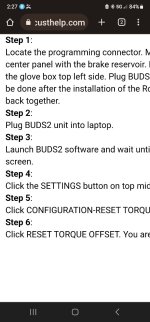

In Glamis now, just hit a witches eye and knocked the right front side pretty good. No major damage but the steering is wanting to turn right only through the power steering. Alignment is fine. We've narrowed everything down to being an issue with the DPS steering system. Need a BUDS2 reader to reset the steering system. Long shot...... anyone out here that can help? Cold beer on ice on pad 4
