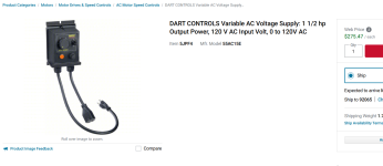

Based on the partial wiring schematic pictured, I think that's going to do the same thing as the controller you already bought. It appears there's a 3ph hookup schematic off the picture to the right. If so, a single phase AC to 3ph VFD controller would work perfectly.Prob about 50% or more...it's scary how fast it is now. We havent even put the horses on it yet....maybe the VFD is the better route? I only have 120v tho.

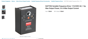

Something like this?

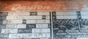

*** EDIT *** NM. That's a capacitor start motor (assumption since it says capacitor motor on it), VFD won't work either.
You're either going to need to replace the motor with a VFD compatible motor, or pulley it down.
