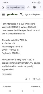

And talking to a couple of different guys that used to work for us and did all of our diesel work. After getting all the info from them I'm going to stay away from a Chevy and buy a Dodge. Stick with the 6.7. just have to be careful of the aluminum injector pump on the 2019 and 2020 trucks. Probably go with a 3500 single rear wheel. Would like to find the exact weight ratings on the ww le3505. I am assuming I will be fine to hook that up to a srw late model Dodge truck 3500.

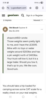

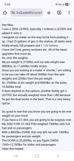

So I found some info on the weekend warrior le3505. So let's say I load this thing to the gills at 16,000 lb gross weight. Who knows what the pin weight would be. Could I get away with a newer Dodge or Ford diesel 3500 single rear wheel or would I be better to go to a dual rear wheel. Everything I'm reading seems like that is right at about the breaking point. I've read a lot of guys towing with single but a lot of them say they've done dual and it tows so much better and is safer. One of our guys that used to work for us I was talking to him tonight and he said the newer Ford trucks especially 2018 and 2019 are really good. They are a little priceier but yet I would have a higher budget buying an older weekend warrior.

Buy the Ford dually and don't look back. It's the best truck on the market. The WW 3505 is a great trailer but heavy as shit. Good luck with whatever you decide to do.

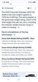

Getting closer to figuring this out. Found my trailer. WW CR3905. 4 feet longer than the LE3505 and 1350 lbs heavier. This link from JD power says this trailer is 11,600 lbs dry. I can't seem to find anywhere the carrying capacity and hope it is 6000 lbs like the LE3505. What a neat trailer. optional up to 2 slides. They are small though. One for the couch and one for the bedroom closet area. But I think would make all the difference in the world. 16' to the slide so perfect for the Funco with 1'3" to spare. Going in the morning to drive a new 3500 Chevy Duramax dually. I like it has a 100,000 mile powertrain warranty on it. LT more of a base model is 74k plus tax and fees. I see several nice cr3905s with 2 slides for $25-32k. This would keep me under my $125k budget. Only thing I am wondering is if I could buy another diesel pusher with a light aluminum enclosed box trailer for my wifes little Audi TT with that same budget. I am guessing an all aluminum box trailer 20' would be 25k. That leaves 100k for a used pusher. If we were traveling and stopping at campsites it seems like it would be a PITA with a trailer and pulling a car in and out. Just need to think about this a little more and research.
