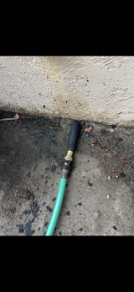

Can I start with this before I drag a snake on the roof? Sink vent is located on the second story roof.
does it drain if you put a hose in the clean out ? then it's the pipes inside or the vent. that dishwasher hose should have an air gap on it or at least a loop.

It was a clogged vent. Got on the roof with the hose and small hand held snake. After the debris was removed I flushed the roof vent and the outside clean out for a few minutes.
Thanks for everyone’s advice.
Forgot to mention, sometimes if you think it's a vent, you can run water and leave the clean out open, that will vent the line and it will run fine, but as soon as you screw the clean out cap back on, it stops running..... sorry about that. Glad it was an easy fix....
