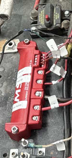

Is the Switch Pros running the fuel pump via the ECM, or on the ignition switch? Only bummer I see is you lose the "engine ain't spinning, no pump" safety feature.
Low pressure oil pressure switch would fix that.
AC Delco makes one that can be used with power or ground.
I have the part number somewhere if anyone needs it. Google works too.
