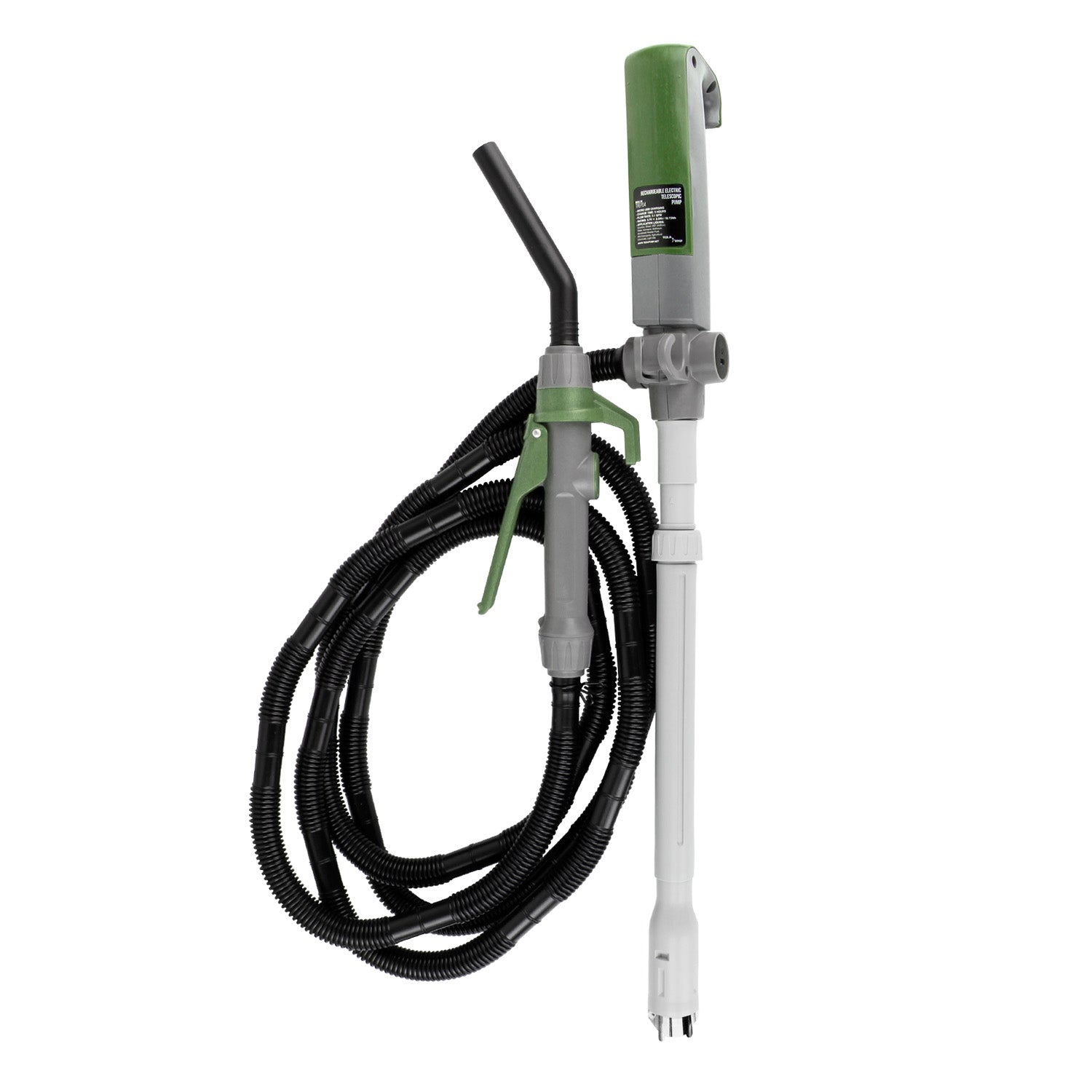

Another Wallet-friendly option- https://www.wurxcontainers.com/fuel
I hate dealing with a gang load of fuel jugs in my trailer, so I bought 3 of these and a transfer pump and they have been great.
