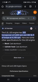

Well after screwing around all morning at least I got something done today. I would say she needs an oil pan anyway. Lol. Even this motor stock with a set of headers will make high 300s and 400 torque. No slouch for that light little car. Have to decide if we're going to run the variable valve timing or put the cam lock out in the phazer gear. Would like to just clean this up and throw a pan on it and install it..
