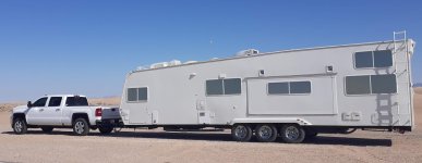

I know they are way under rated on the factory literature, and I know they are f-n heavy as shit.
Anyone here know there tongue weight on a ww bumper pull?
I have an 07' fsw 34, (yea, its 40' feet tip to tip) all the bumper pull larger models & years would be sorta close, sorta. Anyways, anyone have know the tongue weight?
Please advise, thanks in advance

I weighed my tongue weight in multiple configurations using a Sherline tongue weight scale.
All weights included 2 6V batteries on the tongue, full propane and 30 gallons of gas in the fuel tank.
1. No water, no toys: 1275lbs.
2. Full water, no toys: 1650lbs.
3. Full water, 2 full size quads, 1 golf cart in the back: 1600lbs
These trailers have LOTS of tongue weight.
The 26' was even worse, with just 2 axles.
Hope this helps.
Obviously, what is in it dictates the number but my memory, best guess and research puts you at a 1500 - 1800 lb tongue weight.

I had a 07 FSW 34 that measured 42' from ball to rear. I hung a load cell from my forklift and the actual tongue weight was 2550 with roughly 100 gallons of water, no sand car or dirt bikes. In the 6 years I owned it I went thru 2 class 5 truck hitches due to wear in the pin and also cracked one equalizer brand hitch (luckily i noticed the crack starting). with 90psi in my airbags it actually towed pretty good! I kind of miss that trailer, I was scared to run it over scales but it felt heavier than the 3905 FW i have now!
