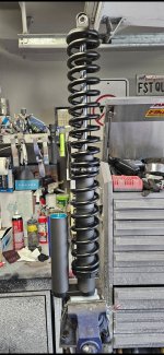

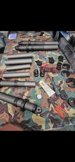

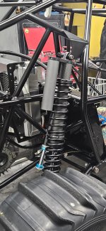

Most of the shock comes apart pretty easy but the cap and the rod ends not so much....lol. King will do it for you but I found someone that had the shock body clamps to do it for me. I hit up Ryan at Rockstar coatings and had him do the cerakote for me. I think he did a great job, his prices are very reasonable and I would not hesitate to use him again. You have 3 options... You can take the shocks apart yourself. You can take the shock to him and he will have them disassembled and re assembled (pretty Pricey) or he said he can tape the shock off and do them assembled. He uses the non bake on cerakote which has a higher temp resistance then the bake on cerakote ( I know, that doesn't make sense...lol). It is also solvent proof.
