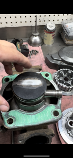

Initial impressions when picking it up. For what i paid it was a steal. Its all stock except tall seat, desert tank, fmf pipe and q silencer, bumpers, lonestar arms, steering stem, and triple rate works shocks. It has no front brakes at all (calipers lines etc.) the seller kept the rear paddles so i brought rear wheels and tires from my 250xIMG_8258.jpeg
This week i took fenders and tank off. Cleaned the carb(boiled in water/vinegar), cleaned the tank, changed plug and put a diff plug cap on and she fired right up. When buying an older two stroke or even when changing types of oil you use when mixing gas; its wise to run at least one 15 min idle cycle with the new oil. I ran two because im a psycho.
I ordered some front calipers, braided brake lines and a master cylinder/lever assembly off ebay. It should be here next week. Duncan racing helped me out with some factory 250r wheels front and back and some new gbc xc master tires. It wont be making any trips this week with me as the clutch is slipping really bad. I have a new hinson basket and factory clutch on order, as well as works connection cable and lever/perchIMG_8297.jpeg
