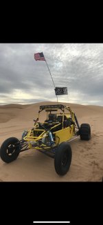

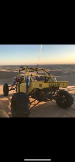

I've owned 2 king sand cars. Number 19 and 48. My advice would be to find the newest car(highest number build) possible and maybe one with a turbo lol. The older cars have frame issues at the shock mounts, rear cage, and trailing arms. I had to completely redo the frame on the # 19. #48 had all the frame updates and ran great. Ill post some pictures if I can find some. They are fun machines and they love fresh powder dunes

Here are some pics
