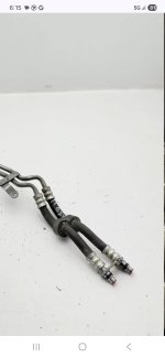

Have a transmission line (hardline/soft line assy) on my wife's Audi that has started leaking at the crimp. Looked at buying a new one. Cheapest I can find is freaking $600 +tax and shipping. That is ridiculous. So before I spent that figured I would see if a hydraulic hose shop could fix it cheaper.

hose man might be able to cut off flex hose, weld on an aluminum bung and then make two short flex hoses
do you have a factory part number for each hose? i can check with a few of my suppliers
if you don't have part numbers you could pm me with your vehicle plate number
Being that they are low pressure lines with light crimps, you might have better luck at a place that makes A/C hoses.

OEM PN is 7L8317801F
So Cal Hydraulics is on Olde Hwy 80 by Bongiovannis. They repaired a stabilizer jack on the motorhome for me, and their website says they can do custom hoses. Might be worth a call.
If someone can't replicate it, but has the crimp dies, you could try having them re-crimp offset (further back/forth) of the original crimp.
