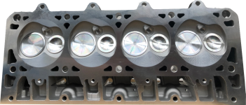

This is a "Billy Bad Boy" build I just finished for Kevin "Coin Pocket" in my crew Should make some serious HP on the Dyno this week, but its really made to Dune and be driveable and very relaible
A few Specs for those who Care:
454 LSR Tall Deck All USA parts Callies ULTRA rotating Assy, Racetec Pistons - custom for this appication, I been working with CPR ( my machine shop) on some custom heads based on their castings- this engine has those - they flow less than the All Pros - the gold standard (these are Ls3 port All Pro are LS7) and slightly edge out the M311 Frankensteins in all areas, we softened the chambers on the heads and are running Manley Valves and Pac springs and Titanium retainers. Kenne Bell 4.9 Supercharger with a 168mm Throttle Body, and Custom drive I built. Dailey Dry Sump, (3 gallon oil change $$) CAMs are always the key, I worked with a respected builder in the midwest I talk to often that builds 1400-1500HP engine similar to this and he supplied the cam proven in similar applications, but owner wants to keep specs secret. Upgraded the Fuel system -Holley Hydramat in the tank, 5GPM brushless speed controlled Aeromotive in tank pump and Pro Regulator , -12 and -10 XRP Pro Flow hose throughout and Bosch motorsports injectors. Everything is top shelf on this build and lots of time in the blueprinting and assy. Motec M130 Engine Management ( would have preferred Holley ... but Owner had the Motec, the PDM and Dash)
Set up to run e85 and 91, Looking at 18-20 psi on e85. In a 2 seat SCU set up for big power, and backed by an Albins 5 speed Sequential. Should be a Fun ride...
