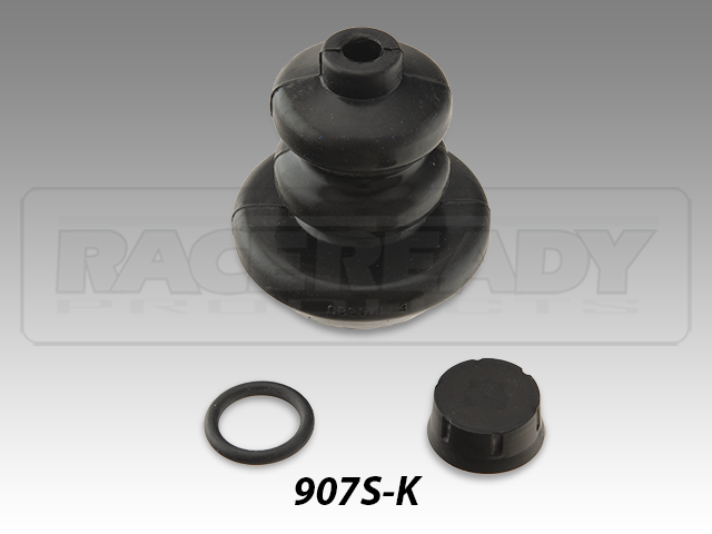

Anyone use these yet? Or have an alternative.\?
Race Ready Products > Cnc Master Cylinder Seal Kits
