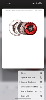

Always had issues with Kennedy double disc clutches. Tried different pressure plates and flywheels, tried making our own thicker floaters along with thinning the discs to keep stack height the same. Kennedy has checked everything years ago. We keep ripping the fingers off the floaters. Time to move on switching to a McLeod double disc. I just didn’t expect a little Vw would be so hard on parts

Yea that is correct, motor builder says same thing. Never seen it before. I have two races on clutch and all tabs are bent already. My original thought was flywheel was machined incorrectly, third flywheel now it’s not the issue. I have probably ripped the ears off of 5-8 floaters over a 10 year span.
Motor builder is blaming it on the trans, we leave at 7200rpm on two step at 30ish lbs of boost. But he’s blaming it on the air shift. There’s no give at shift
