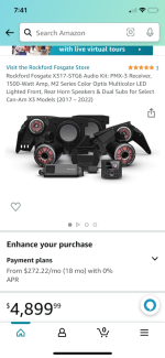

Hello duner friends!! I just picked up a 21’ X3. Super low mile, mostly stock machine. I want to put a rocking/pounding stereo in it and would like some advice as to what really sounds good. I’ve got a thumper sub in my rail (1000watt single 10” in solid box molded into Extreme car, rattles your brain) and good loud/good stereo in my RZR (single 10” sub in box between/behind seats) and would like same nice/loud bass thumping thing in the new car. I have head sets in my rail and sweet stereo and use both (love the feel of the bass pounding while hearing audio through head sets), so my plan is to do both in X3 as well so appreciate any comments to that end. I see that Rockford Fosgate makes a 2x10” under seat plus nicely mounted fronts, plus hanger back speakers for like $5k. That’s the route I’m thinking and can install myself, but wanted some opinions on whether that’s good/bad system or if for $5k I should be going to SXS stereo shop for better or….  I’m located in PHX area (Flag in summer) if stereo shop is your recommendation; not willing to travel far for install.
Thanks for looking! Any advice will be appreciated!
I have a rockford stage 4 in my 2 seater can am x3 and it hits pretty hard and I can hear it at just about any speed.   Ive had it about 2 years its held up to the elements well.  It was already installed when I bought mine so I have no help for installer.
I do these for a living, the fosgate setup you’re looking at is well put together which makes it easy to take on for installation. They have a quick install video and tech support if you have questions. At that price point you could have a much better setup using parts from different manufacturers but as a result the install would become far more complex.
Rockford Rocks,,,, Well worth the money.... BUT... Do yourself a favor and upgrade your battery and also install a second one... UTV stereo in AZ have the set up for you. Dont do it without installing a second battery... If your sitting around bumping tunes, you could lose power and not start the machine.

The ‘21 canam have a sensitive voltage system the displays a battery waning in the dash when too much power is consumed. As far as a battery upgrade, I recommend a single big battery (pc1200 and a UTVINC battery hood down) vs a dual battery dual maintenance charger. Dilemma with 2 batteries is running you stereo on battery number 2 and draining it will add even more load on your charging system when the car is running. Money saved on 2 battery setups (battery he battery, tray, isolator and wiring) is much better spend on a larue alternator kit
