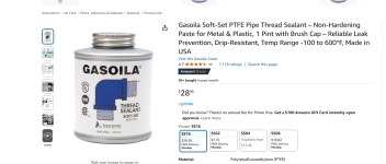

Maybe one of the Gasoila products...they sell the soft set at tractor supply (the blue one)
