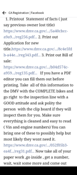

Its not difficult. You will have to write an affidavit about how and when you acquired the bike. I registered my full suspension 70 without a single receipt! Wrote it out as it was a 5 year project, all parts were bought or traded for used from private party. Mine didn't even have a vin on it.
This is in the files page on the FB 70 parts page. I typed it up years ago could save a trip to the chp.
