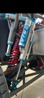

I'm looking at buying a sand car and there are a few concerns I have that I will need to fix if I were to buy it. Biggest question...what's the going rate on rebuilding all 4 King bypass shocks and all 4 coil overs? This car has been sitting for a bit and these shocks need to be gone though. Just wondering roughly what I'll need to spend

If you're not revalving or doing any color change, you should be a $200-300 per shock.
I had King rebuild all 8 of mine in 6/24 and it was $1,260 out the door.
