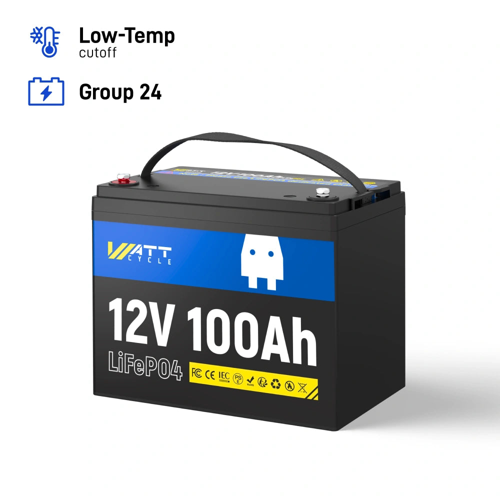

I would up grade current batteries to LiFePo4, add a second large amperage changer (125A ish) and run your onboard generator 1 hour a day to top them off.
When you add solar panels on the roof all you get is extra holes, wiring in cabinets and a whopping 40A at best charging when the sun is out. Sure solar is great for maintenance charges but you will need a whole roof of solar to do it right.
I have had good luck with Watt Cycle batteries and RecPro chargers for budget systems. Victron chargers is you have the dough.
Jackery and Ecoflow and others are great brainless solutions if you just want to buy something and plug it in. Both charge at about 1000w, so will top up pretty quickly. A 3000Wh unit will run for ~2 days with the AC fridge running and other typical crap onboard (microwave, TVs, phone chargers, propane heat, but no AC), and charge in 3 hours ish. If you do other camping or activities without the RV, it works out well, but as @megadesertdiesel suggested, upgrading the batteries and getting a larger charger is a cheaper solution (about 1/2 price for similar Wh storage and charging rates).

I have tweaked the diagram a little to add a second set of buss bars and a Victron bluetooth shunt right after the batteries to watch battery level and left the other shunts to monitor each charger level. I also added two more 100AH batteries for a total of 500AH with room to add three more if i feel the need. I run residential refrigerator and Starlink 24/7.
I use the 100AH non bluetooth batteries and then rely on a shunt to tell me Bluetooth info.
My Onan 5500 will run the two added Rec Pro chargers and the built in 75 amp no problem, but nothing else. Run the micro wave and pop a breaker. I normally leave the 55 amp charger off unless my batteries are very low and i need a quick zapp.
