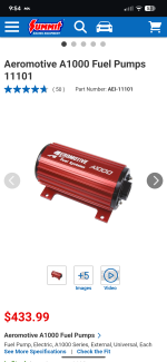

I ran that Walbro on my NA V8 with no issues. I've got an A1000 on the current supercharged setup.

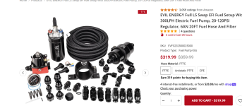

Anyone running evil energy fuel pumps / fuel components? It's insane how cheap they are for all components - with good reviews online. There's nothing magical (in my opinion) about a fuel pump and pressure regulator to justify the insane cost aeromotive charges. The below would be like 1500 if brand name?

Ton of reviews I read said they are noisy AF and had a pretty short lifespan🤷‍♂️. I had a brand new "MostPlus" Bosch044 clone sitting in the garage that looked identical to the EvilEnergy pump. I started putting that in to temporarily replace my noisy old Walbro, fkr leaked at the top seam with just gravity weight from the tank. Trashed that junk.🤨
