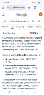

So we drove this coach back after buying it almost 900 miles. After reading online it sounded to me like 225 was the max temp that a lot of people don't like to go over. Right in the middle of summer and temperatures above 100 on some of the hills I was getting it up to 220. Of course gearing down and keeping the RPMs up. Just talked to a friend of the family that owns a diesel repair shop. He thinks 220 is still a little hot for that motor. Side radiator and it did have some dirt in it that I have rinsed out but it wasn't real bad. If I remember right the dash light for coolant temp comes on around I think 210 or 215. Don't remember exactly. This is a country coach and did come with the upgraded and engine monitoring system with a bunch of sensors. So I'm assuming the engine temp is correct. Certainly seems to be a little more accurate than the factory gauge on the dash.

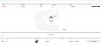

Id be curious what thermostat is in this engine. Do you have the engine serial number handy
IMO that rig should hold 180 all day long. Pulling a grade with a trailer may see 190-195 but come down quick once leveled out. Does this have a tuner on it? Do you have an exhaust temp gauge?
Well your comment asking about the engine numbers made me think why don't I just call cummins. Answered their phone within 2 minutes. Guy was really helpful. He looked up my engine and said that thermostat opens at 203°. He said he would not go over 225 with that motor. He did talk about how fast the motor cools down once you get done with your climb and this thing cools off very quickly just like it should. So I think it's all good. I will rinse that radiator out one more time since I can see a little bit more debris at the bottom of the fins. I was also thinking about a pyrometer to check egts before I even posted this. He said not really necessary.
