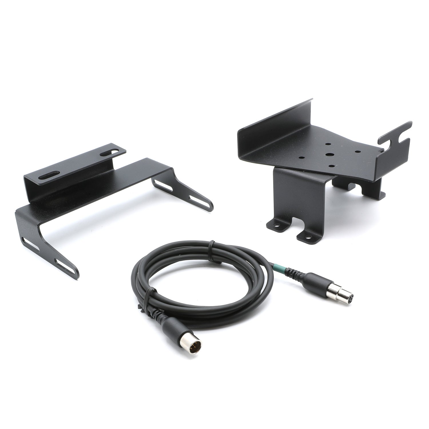

How is everyone mounting their radios in the new Can-Am Mav R? Say 2024 or 2025 models.
Rugged has the mount that goes under the dash on the driver's side and PCI has a mount that goes in the cup holder. For some reason Can Am did not layout the interior with the thought of people mounting radios.

we did the rugged system. poor instructions, you haveto basically remove the entire interior. wires run everywhere. the radio on your left knee must always be put in lock mode or you will wonder why no one can hear you cause you accidentally changed freq. The controls for the intercom are not intuitive. i have rugged system since 2006 in my sand car and it is really nice easy to install and intuitive to use.
